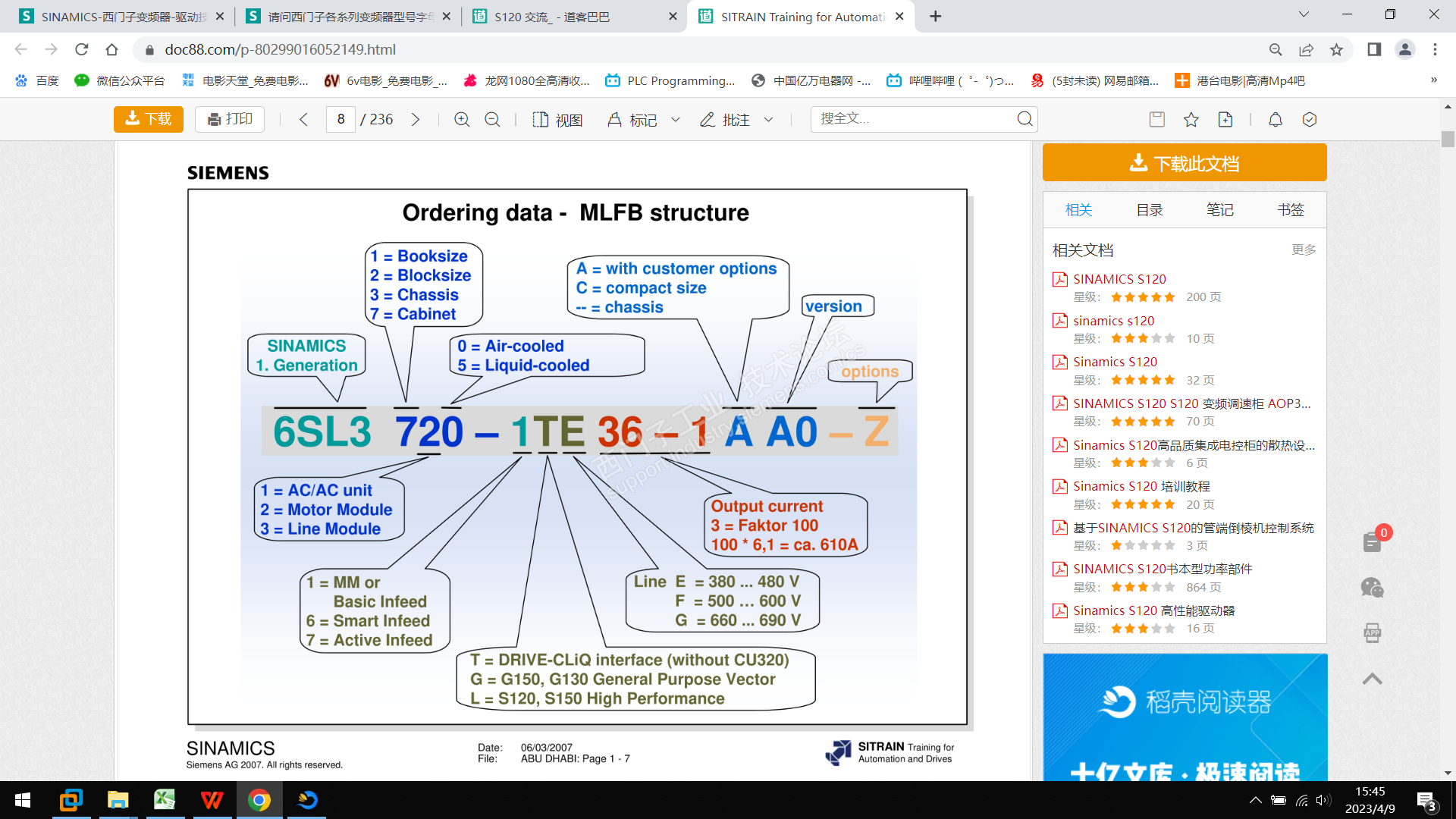

网上找的,S120订货号含义:
SINAMICS
