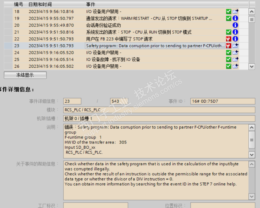

CPU 1515F-2 PN做主站,CPU 1215FC DC/DC/DC做从站,用无线走安全通信,运行中突然切换STOP
1.CPU 临时错误:用户在 FB 223 中编写了 STOP 请求 将影响 OB 123 的执行
 RCS_PLC / RCS_PLC
2.错误:Safety program: Data corruption prior to sending to partner F-CPU/other F-runtime group
F-runtime group   1
HW ID of the transfer area:   305
Input SD_BO_xx
 RCS_PLC / RCS_PLC.
请问这有解决办法吗?
