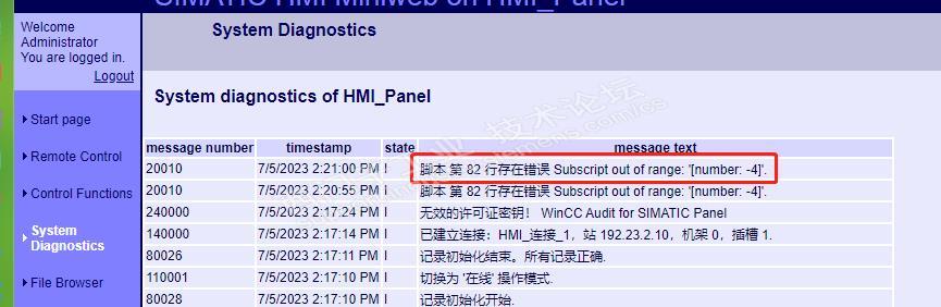

有大神能给分析一下 82句这脚本出的是什么错?

Sub Stockage_SD()
Dim f
Dim fo
Dim fso
Dim ts
Dim data
Dim splitdata
Dim delimiter
Dim arrayData
Dim arrayLength
Dim usedsizeMB
Dim usedsizeBYTES
Dim freesizeBYTES
Dim totalSizeMB
Dim freesizeMB
Dim strArr_realData
Dim temp
Dim commaDelimiter
Dim storage_path
Dim filename
Dim myfile
splitdata=0
delimiter=" "
commaDelimiter=","
'storage_path = "\Storage Card SD\"
storage_path = "F:\"
filename = "dirinfo.txt"
'Set fso = CreateObject("FileCtl.FileSystem")
Set fso = CreateObject("Scripting.FileSystemObject")
'Set myfile = CreateObject("FileCtl.File")
'Delete text file if it exists (dirinfo.txt)
'If (fso.Dir(storage_path & filename) = filename) Then
If fso.FileExists(storage_path & filename) Then
'fso.kill(storage_path & filename)
fso.DeleteFile(storage_path & filename)
End If
'Delete batch file if it exists (cmddir.bat)
'If (fso.Dir(storage_path & "cmddir.bat") = "cmddir.bat") Then
If fso.FileExists(storage_path & "cmddir.bat") Then
'fso.kill(storage_path & "cmddir.bat")
fso.DeleteFile(storage_path & "cmddir.bat")
End If
'Create batch file
'Set fo = CreateObject("FileCtl.File")
fso.CreateTextFile(storage_path & "cmddir.bat")
'fo.open storage_path & "cmddir.bat",8
Set f = fso.GetFile(storage_path & "cmddir.bat")
Set ts = f.OpenAsTextStream(8, -2)
' mode "8" to append to file
' mode "2" to overwrite file
''fo.lineprint("cd " & """\Storage Card SD\""")
'fo.lineprint("cd " & """F:\""")
'ts.WriteLine("cd " & """F:\""")
ts.WriteLine("chcp 1252")
ts.WriteLine("F:")
'fo.lineprint("dir /s > " & filename) 'This command will create the file (dirinfo.txt)
ts.WriteLine("dir /s > " & filename)
'ts.WriteLine("pause")
'fo.close
ts.Close
Set ts = Nothing
Set f = Nothing
'Execute batch file
'StartProgram "CMD","/C " & """\Storage Card SD\cmddir.bat""", hmiShowMinimized,hmiYes
StartProgram "CMD","/C " & "F:\cmddir.bat", hmiShowMinimized,hmiYes
'Wait until output is complete
'Do Until fso.Dir(storage_path & filename) = filename
''Do Until Not fso.FileExists(storage_path & filename)
''Loop
Dim dteWait
dteWait = DateAdd("s", 10, Now())
Do Until (Now() > dteWait)
Loop
Set myfile = fso.OpenTextFile(storage_path & filename, 1, -2)
'myfile.open storage_path & filename, 1
'While myfile.EOF = False
'data = data + myfile.LineInputString
'Wend
Do
data = data + myfile.ReadLine
Loop Until myfile.AtEndOfStream
arrayData=Split(data,delimiter)
arrayLength=UBound(arrayData)
Dim i
For i = 0 To arrayLength
If arrayData(i) = "" Then
'do nothing
Else
temp = temp + arrayData(i) + ","
End If
Next
'ShowSystemAlarm temp
strArr_realData = Split(temp, commaDelimiter)
arrayLength = UBound(strArr_realData)
'ShowSystemAlarm arrayLength
freesizeBYTES = CDbl(strArr_realData(arrayLength-3))
usedsizeBYTES = CDbl(strArr_realData(arrayLength-7))
freesizeMB = freesizeBYTES / 1048576
usedsizeMB = usedsizeBYTES / 1048576
totalSizeMB = freesizeMB + usedsizeMB
SmartTags("FreeSizeMB") = freesizeMB
SmartTags("TotalSizeMB")= totalSizeMB
myfile.Close
Set myfile = Nothing
Set fso = Nothing
End Sub
这个脚本多执行几次     偶尔会执行成功,可能10次有7-8次会报错 读不到值
