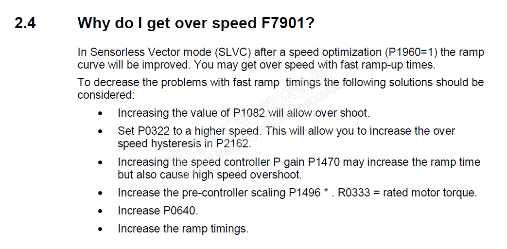

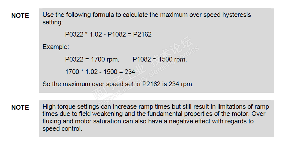

关于F7901故障,我搬个砖。

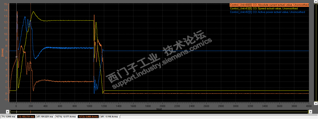

Figure . Screenshot showing the field weakening/saturation of the motor
