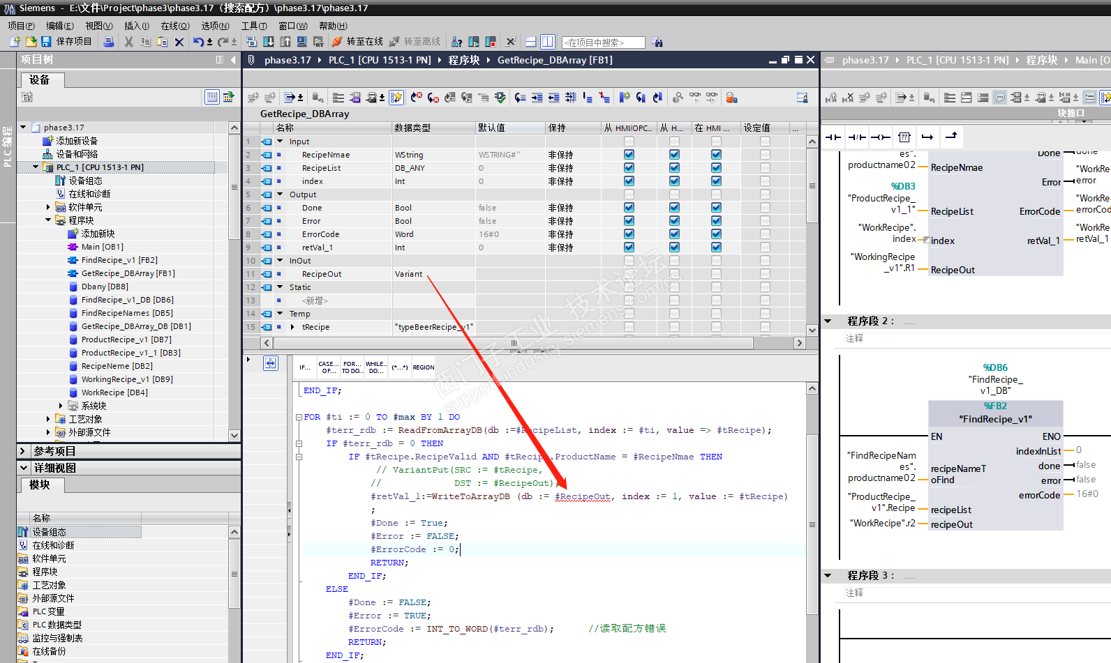

给出的答案是输出DB,改成variant快内报错
