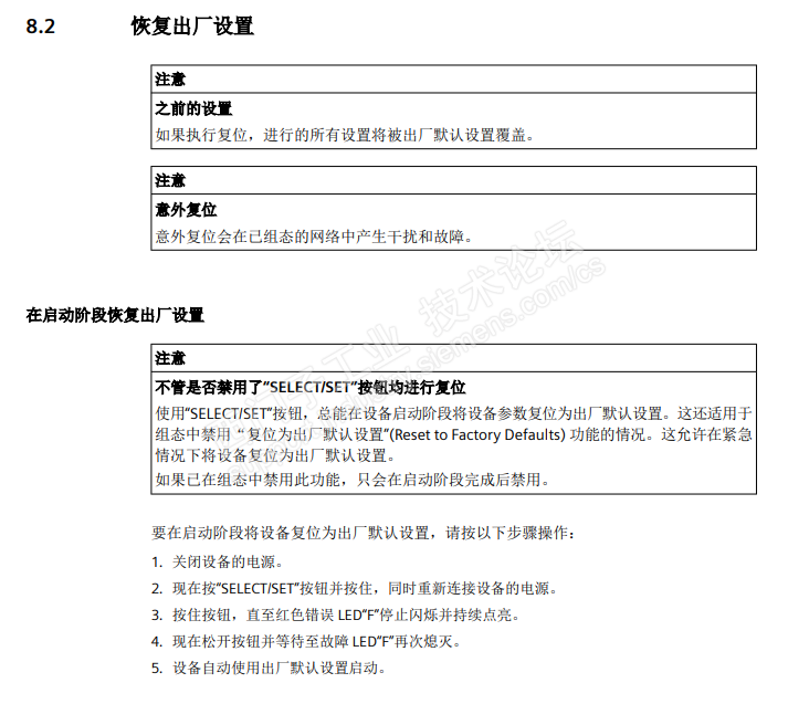

下载地址:
https://support.industry.siemens.com/cs/attachments/109743149/BA_SCALANCE-XC-200_52.pdf?download=true
