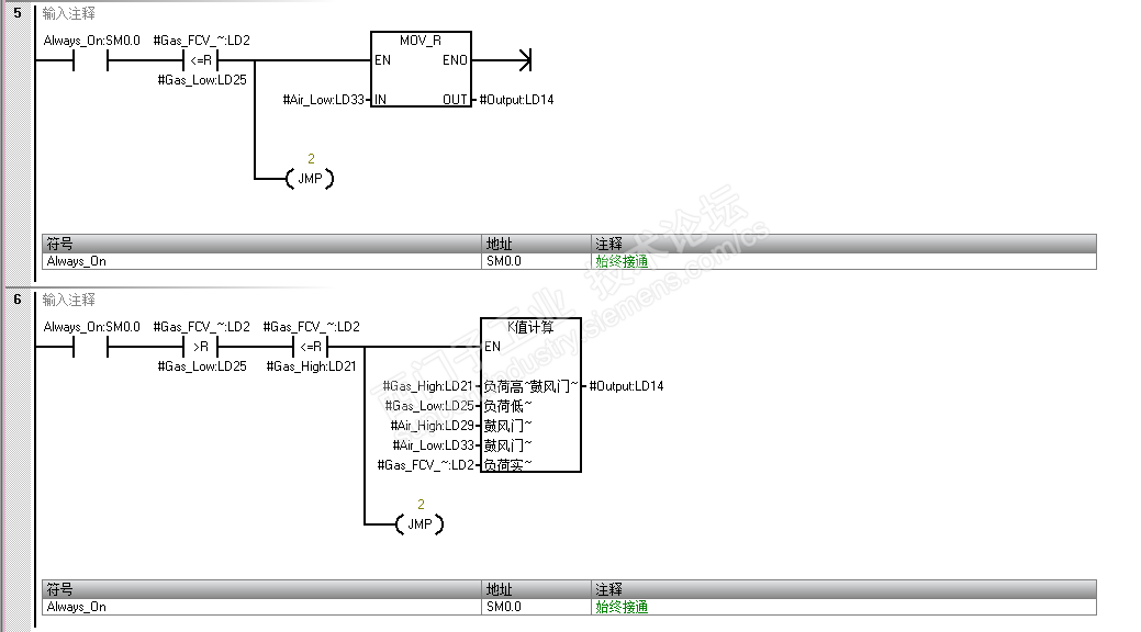

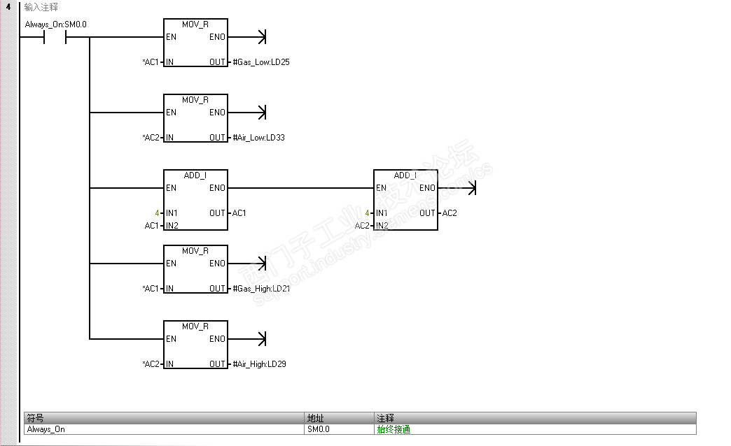

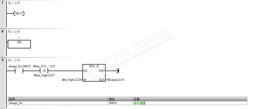

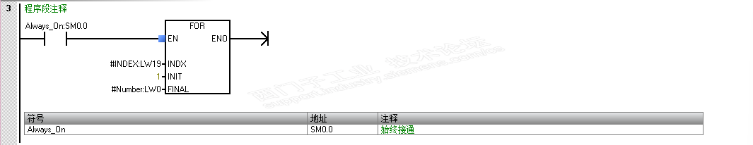

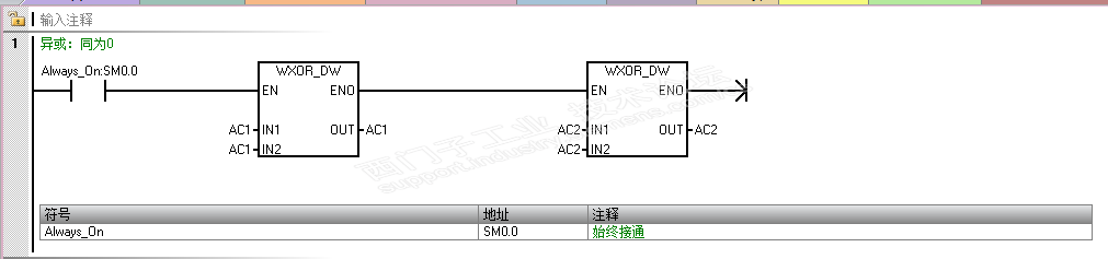

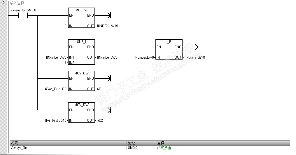

2组数值,例DB1和DB2都是12个数,输入X在DB1中寻找满足DB1.DBDX<X<DB1.DBDY条件后,得出在第几个数,在DB2中找出对应的DB2.DBDX和DB2.DBDY,用现有的FC块算出Y(DB2.DBDX<Y<DB2.DBDY
怎么用于针对DB
