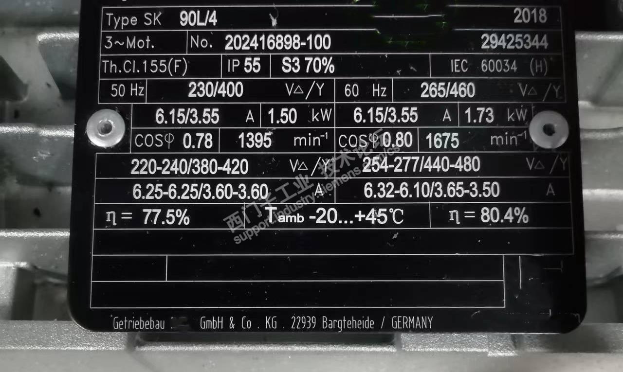

A线皮带机参数
p300[0]    Motor type selection    [1] Induction motor
p301[0]    Motor code number selection    0
p304[0]    Rated motor voltage    400
p305[0]    Rated motor current    3.55
p306[0]    Number of motors connected in parallel    1
p307[0]    Rated motor power    1.5
p308[0]    Rated motor power factor    0.78
p310[0]    Rated motor frequency    50
p311[0]    Rated motor speed    1395
p1082[0]    Maximum speed    1500
p2000    Reference speed reference frequency    1500
p1120[0]    Ramp-function generator ramp-up time    1.07
p1121[0]    Ramp-function generator ramp-down time    1.07
1.4米    速度控制字写入W#16#1810
我们现场就是这样的。
