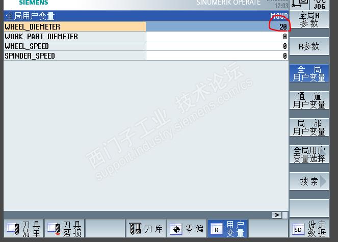

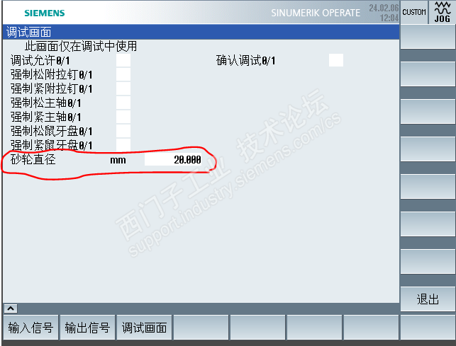

把全局变量做到画面上的测试:
DEF Edit1=(R3///,"砂轮直径","mm",/wr2//"WHEEL_DIEMETER"/10,160,180/200,160,80,//),
