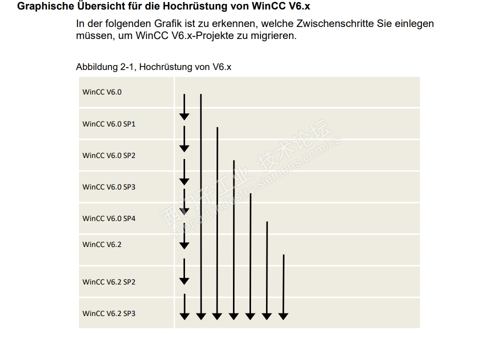

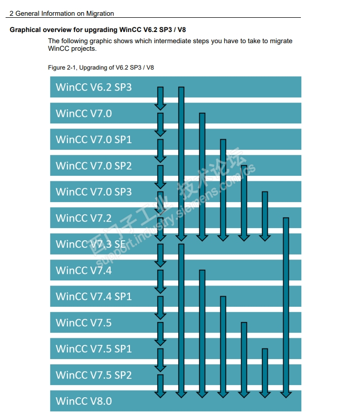

各代WinCC项目移植关系图:
http://www.ad.siemens.com.cn/productportal/Prods/HMI/WinCC/Q1_software/FAQ15.html
V4移植V8及操作方式说明:
https://support.industry.siemens.com/cs/cn/zh/view/44029132
