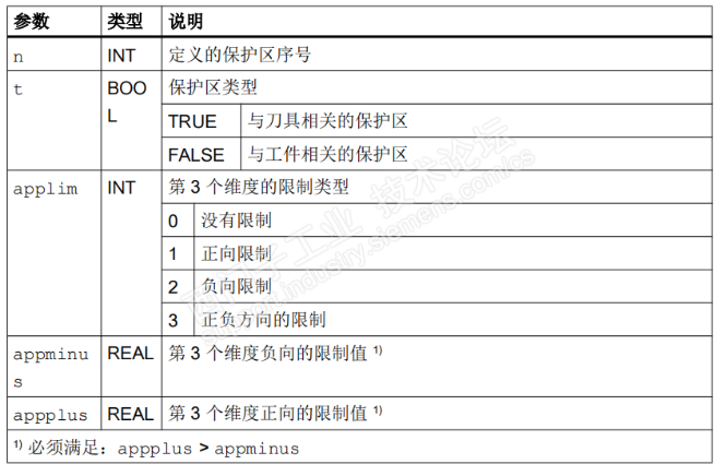

 ● CPROTDEF(n, t, applim, appplus, appminus)
● NPROTDEF(n, t, applim, appplus, appminus)
