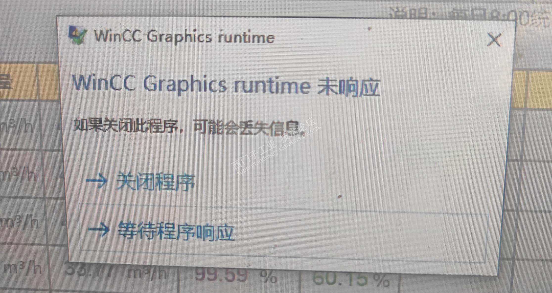

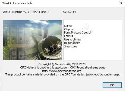

求助 WinCC Graphics runtime 未响应

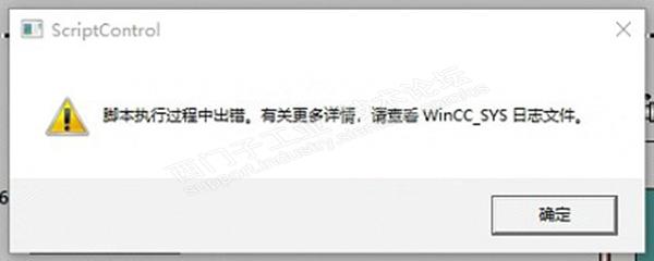

WinCC_Sys_02.log日志

2303,05.07.2024,15:55:57:532,1007000,4,,WINCC-SE1,SCRIPT,ActionOverflow:more than 10000 Actions to work,MSG_STATE_COME

2303,03.08.2024,23:06:14:235,1000005,4,,WINCC-SE1,DataManager Runtime,Format error of tag 'RO10.回收率'. Format ID: 136314880 = 8200000(hex),MSG_STATE_COME
2303,21.08.2024,13:16:06:870,1007000,4,,WINCC-SE1,SCRIPT,ActionOverflow:more than 10000 Actions to work,MSG_STATE_COME//关键是也找不到这个脚本。
