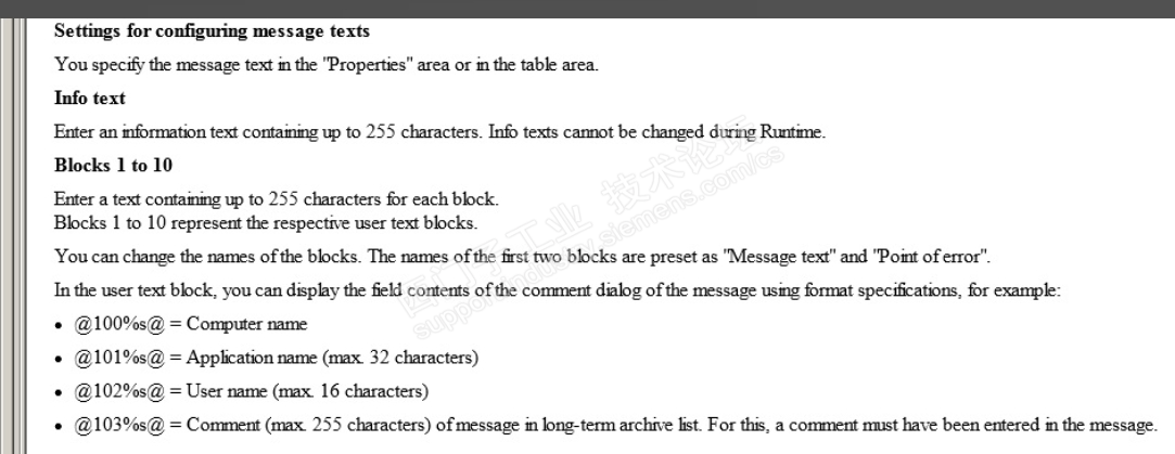

使用wincc自带的系统消息时发现了以下问题

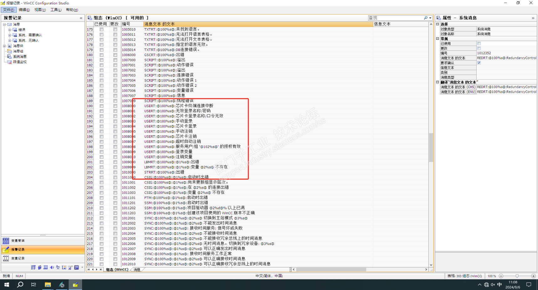

  1. 在用户登录时系统消息记录的文本是USERT:@100%s@:手动登录  这里的@100%s@应该是计算机名称,实际使用过程中也是记录的计算机名称。个人认为 USERT:@102%s@:手动登录 生成的文本更为符合这条消息的意思。

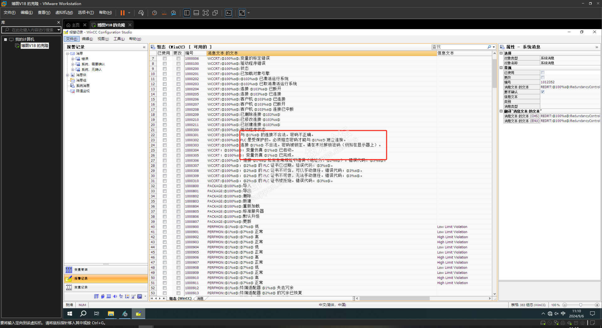

  2. 在检查系统消息时发现部分报警信息出现了@1%s@ @2%s@这类占位符,这些过程中间值与用户定义的部分冲突,在操作记录中显示时会产生歧义
The following problems were found when using wincc's own system messages.
  1. When the user logs in, the text recorded in the system message is USERT:@100%s@: the @100%s@ for manual login here should be the computer name, and it is also the recorded computer name during actual use. Personally, I think the text generated by USERT:@102%s@: manual login is more in line with the meaning of this message.
  2. When checking the system messages, it is found that some alarm messages have placeholders such as @1%s@ @2%s@, and the intermediate values in these processes conflict with the user-defined parts, which will cause ambiguity when displayed in the operation record.
