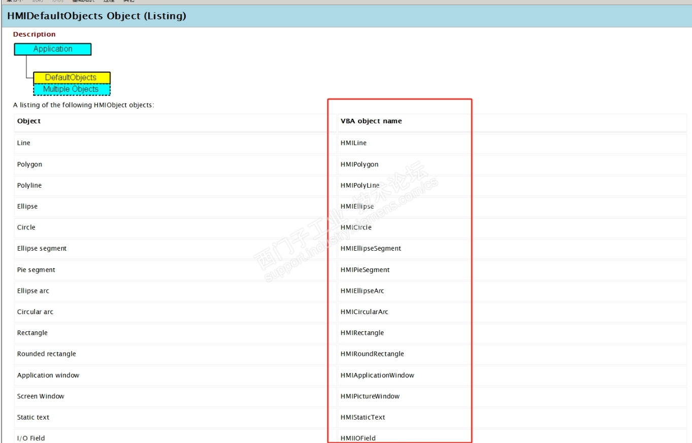

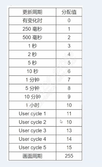

响应时间  是指动态对话框中触发器的标准周期么?我之前改过静态文本的触发器,你可以参考一下。
Sub ChangeTrigger()
On Error Resume Next
Dim objResult, objMember, objCount
    Set objResult = ActiveDocument.HMIObjects.Find(ObjectName:="*", ObjectType:="HMIStaticText")
    objCount = objResult.Count
    MsgBox "对象的数量:" & CStr(objCount)
        For Each objMember In objResult
        objMember.Properties("BackColor").Dynamic.Trigger.VariableTriggers(1).CycleType = 0
        objMember.Selected = True
        Next objMember
        MsgBox "操作完成:"
End Sub
