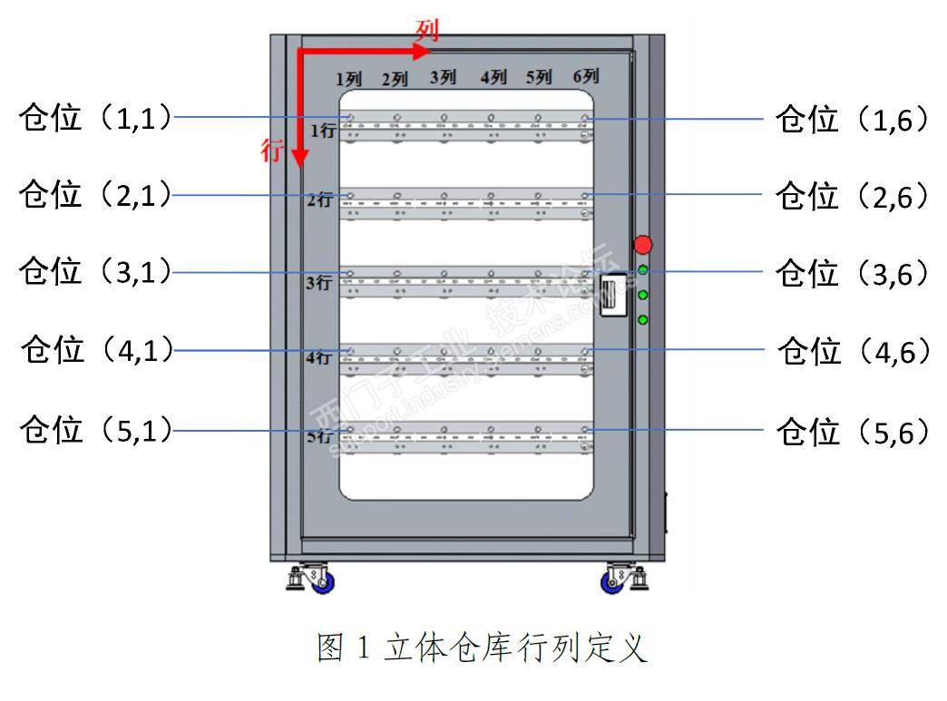

通过机器人完成车床与加工中心的上下料加工,从立体仓库取料,分别放入两台机床加工后,放回立体仓库,布局中需完成以下设置:
(1)车床先行加工;
(2)进行加工中心加工时,机床加工时间设置为30S;
(3)进行车床加工时,机床加工时间设置为15S;
IF "仓位号" <=30 AND "仓位号">=1 THEN
    IF "仓位号"MOD 6 =0 THEN
        "列号" := 6;
    ELSE
        "列号" :=  "仓位号"MOD 6;
    END_IF;
    IF "仓位号" MOD 6 = 0 THEN
        "行号" := "仓位号" / 6;
    ELSE
        IF "仓位号" / 6 = 0 THEN
            "行号" := 1;
        ELSE
            "行号" := "仓位号" / 6 + 1;
        END_IF;
    END_IF;
ELSE
    "列号" := 0;
    "行号" := 0;
END_IF;
IF "行号"=1 OR "行号" =2 THEN
    "夹具号" := 1;
ELSIF "行号"=3 OR "行号" =4 THEN
    "夹具号" := 2;
ELSIF "行号"=5 THEN
    "夹具号" := 3;
ELSE
    "夹具号" := 0;
END_IF;
