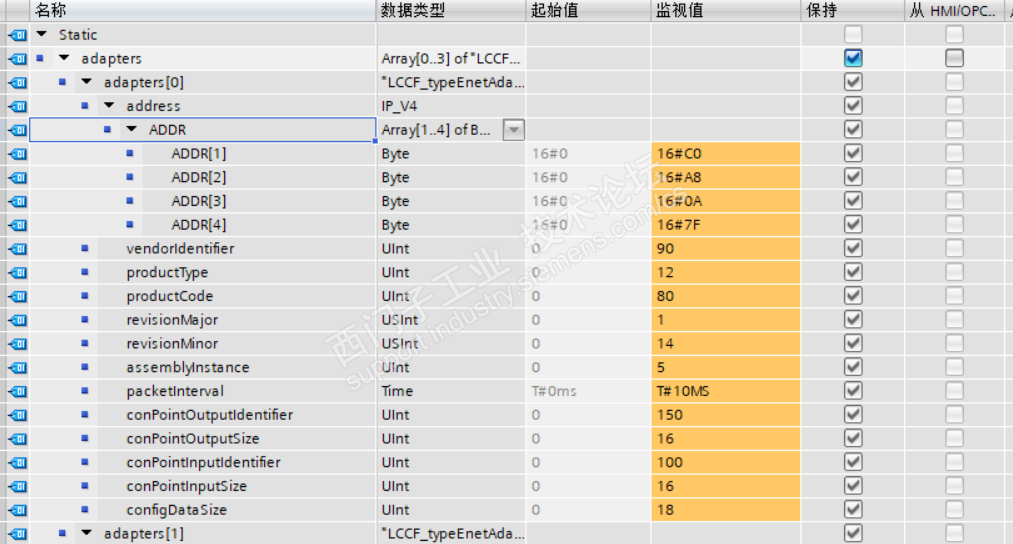

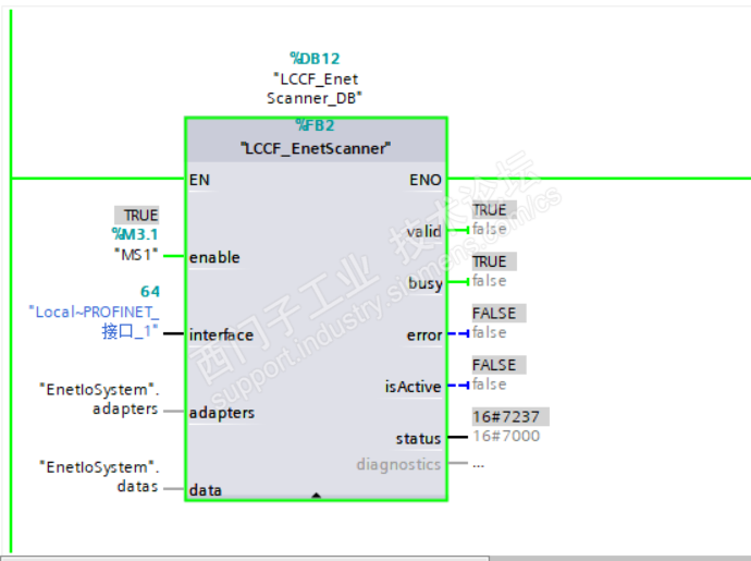

PLC端:西门子s71200 1212C做主端站
三方设备:4台风机,从站 (做adapters)
通讯协议EtherNet/IP协议
博途v17版本,配置完成后,启用运行,始终不能握手成功,反复检查EDS文件配置和LCCF参数设置无果,忘大神们指点迷津

EDS文件部分内容如下:
[Device]
        VendCode = 90;
        VendName = "HMS Industrial Networks";
        ProdType = 12;
        ProdTypeStr = "Communications Adapter";
        ProdCode = 80;
        MajRev = 1;
        MinRev = 14;
        ProdName = "Anybus X-gateway Modbus-TCP";
        Catalog  = "AB9006-B";
[Device Classification]
        Class1 = EtherNetIP;
[Params]
        Param1 =
                0,                      $ first field shall equal 0
                ,,                      $ path size,path
                0x0000,                 $ descriptor
                0xC7,                   $ data type : 16-bit Unsigned Integer
                2,                      $ data size in bytes
                "Output Size",          $ name
                "",                     $ units
                "",                     $ help string
                0,256,16,               $ min, max, default data values
                ,,,,                    $ mult, dev, base, offset scaling not used
                ,,,,                    $ mult, dev, base, offset link not used
                ;                       $ decimal places
        Param2 =
                ,,                      $ path size,path
                "Input Size",           $ name
                "",                     $ units
                "",                     $ help string
                ;                       $ decimal places
        Param3 =
                0,                      $ reserved, shall equal 0
                ,,                      $ Link Path Size, Link Path
                0x0000,                 $ Descriptor
                0xC8,                   $ Data Type
                4,                      $ Data Size in bytes
                "RPI Range",            $ name
                "",                     $ units
                "",                     $ help string
                2000,3200000,10000,     $ min, max, default data values
                ,,,,                    $ mult, div, base, offset scaling
                ,,,,                    $ mult, div, base, offset links
                ;                       $ decimal places
[Connection Manager]
        Connection1 =
                0x04030002,             $ trigger & transport
                                        $  0-15  = supported transport classes (class 1)
                                        $  16 = cyclic (1 = supported)
                                        $  17 = change of state (0 = not supported)
                                        $  18 = on demand (0 = not supported)
                                        $  19-23 = reserved (must be zero)
                                        $  24-27 = exclusive owner
                                        $  28-30 = reserved (must be zero)
                                        $  31 = client 0 / server = 1
                0x44640405,             $ point/multicast & priority & realtime format
                                        $   0     = O=>T fixed (1 = supported)
                                        $   1     = O=>T variable (0 = not supported)
                                        $   2     = T=>O fixed (1 = supported)
                                        $   3     = T=>O variable (0 = not supported)
                                        $  4-7   = reserved (must be zero)
                                        $  8-10  = O=>T header (4 byte run/idle)
                                        $  11  = reserved (must be zero)
                                        $  12-14 = T=>O header
                                        $  15  = reserved (must be zero)
                                        $  16-19 = O=>T point-to-point
                                        $  20-23 = T=>O connection type (multicast or point-to-point)
                                        $  24-27 = O=>T scheduled
                                        $  28-31 = T=>O scheduled
                Param3,Param1,Assem150, $ O=>T RPI,Size,Format
                Param3,Param2,Assem100, $ T=>O RPI,Size,Format
                ,,                      $ config part 1 (dynamic assemblies)
                ,,                      $ config part 2 (module configuration)
                "Exclusive Owner",      $ connection name
                "",                     $ Help string
                "20 04 24 05 2C 96 2C 64";    $ exclusive output path
