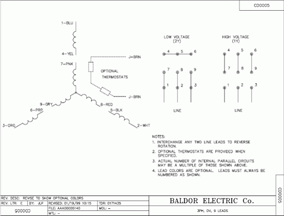

http://www.globalindustrial.com/site/images/universal/baldor/specs/BM3546T.pdf
