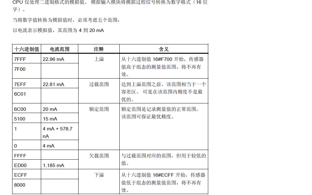

manual:http://support.automation.siemens.com/CN/view/zh/17473828
