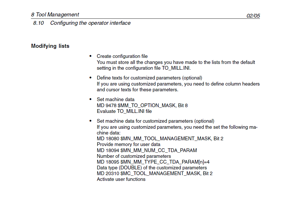

回复:如何修改刀具管理系统中,“刀具列表”的界面?

9478 $MM_TO_OPTION_MASK
MD number Settings for ShopMill
Bit 8: Evaluate file TO_MILL.INI for configuration of the tool management user interface.
