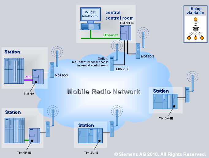

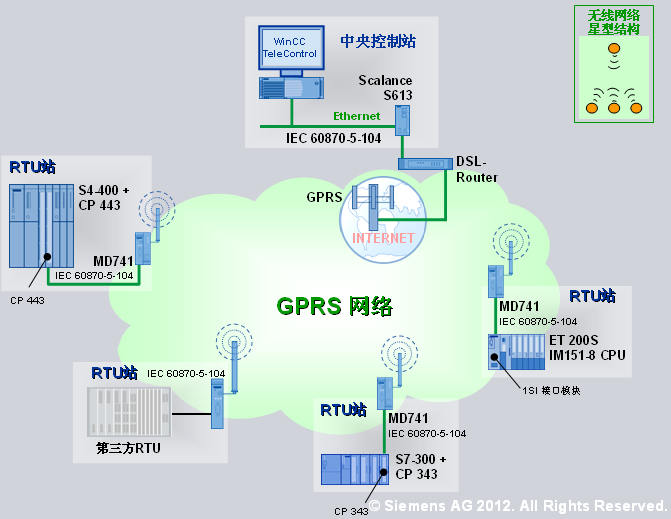

quote:以下是引用Fxiao_New在2012-03-20 09:41:04的发言:
请问如果两台 wincc 电脑之间通过广域网通讯可以采用 telecontrol 的方案吗?谢谢
Wincc Telecontrol就是广域网的通讯解决方案,当然广域网是兼容局域网的,下面是一些广域网的通讯架构实例:
1 SIMATIC WinCC TeleControl with IEC 60870-5-104 基于IP传输的GPRS网络
2 SIMATIC WinCC TeleControl with SINAUT ST7 Classic WANs mobile radio (GSM) with data service CSD
3 SIMATIC WinCC TeleControl with SINAUT ST7 Classic WANs Dedicated Line
4 SIMATIC WinCC TeleControl with SINAUT ST7 Classical and IP-based WAN – redundant communication path
5 SIMATIC WinCC TeleControl with SINAUT ST7 IP-based WAN Secure Networking via unsecure Networks
