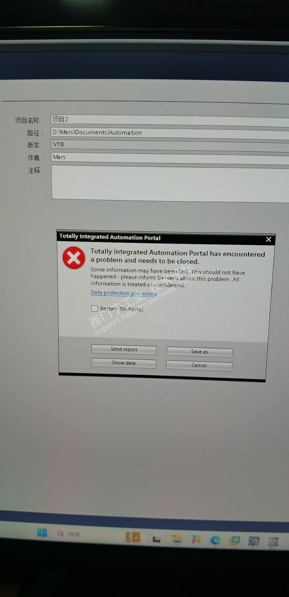

win11企业版博图18新建项目直接崩了-复现了过程

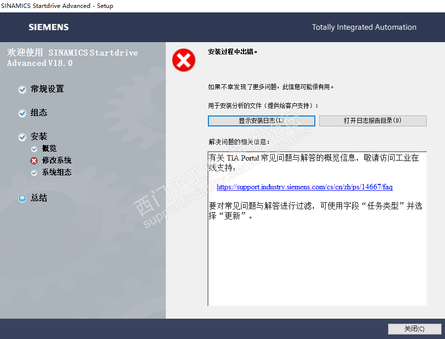

找到原因了,但是不知道怎么解决……卸载了博图就可以正常使用。
只要安装了“STARTDRIVE_ADVANCED_V18”就提示安装过程出错。
兼容性肯定没问题,虚拟机里win10 LTSC 2021都试过,同样的问题。

虚拟机的安装日志如下:
2023.03.15 15:40:12 - Year.Month.Day - Log start
BUNDLE: SINAMICS Startdrive Advanced V18.0
SEBU Version: STARTDRIVE:V18.00.00.00_28.00.00.01
OS: Microsoft Windows 10 IoT 企业版 LTSC - Unknown product, 64-bit, build 19044
COMMANDLINE: C:\Program Files (x86)\Common Files\Siemens\Automation\Siemens Installer Assistant\410\SIA2.exe /starter /bundlepath=D:\InstData
INSTALLDIR: C:\Program Files\Siemens\Automation
SETUPLANGUAGE: 2052
PRODUCTLANGUAGES: 1033;2052
CHANGES: (+)DotNet_Updater;(+)STARTDRIVE-G120-FW476
There are NO severe messages before the installation

15:40:53 |ERROR    AdsWorkerSetupPackage::OnWorkerCompleted():  - SetupPackage setup failed due to unknown error
15:40:53 | FAIL!                     SetupUnit                  (STARTDRIVE-G120-FW476)     Failed    PlusOptionalAddLocal

Intermediate ExitCode after execution queue : 1603 - Exit code means: Installation failed (InstallFailure)
Errors: 1
