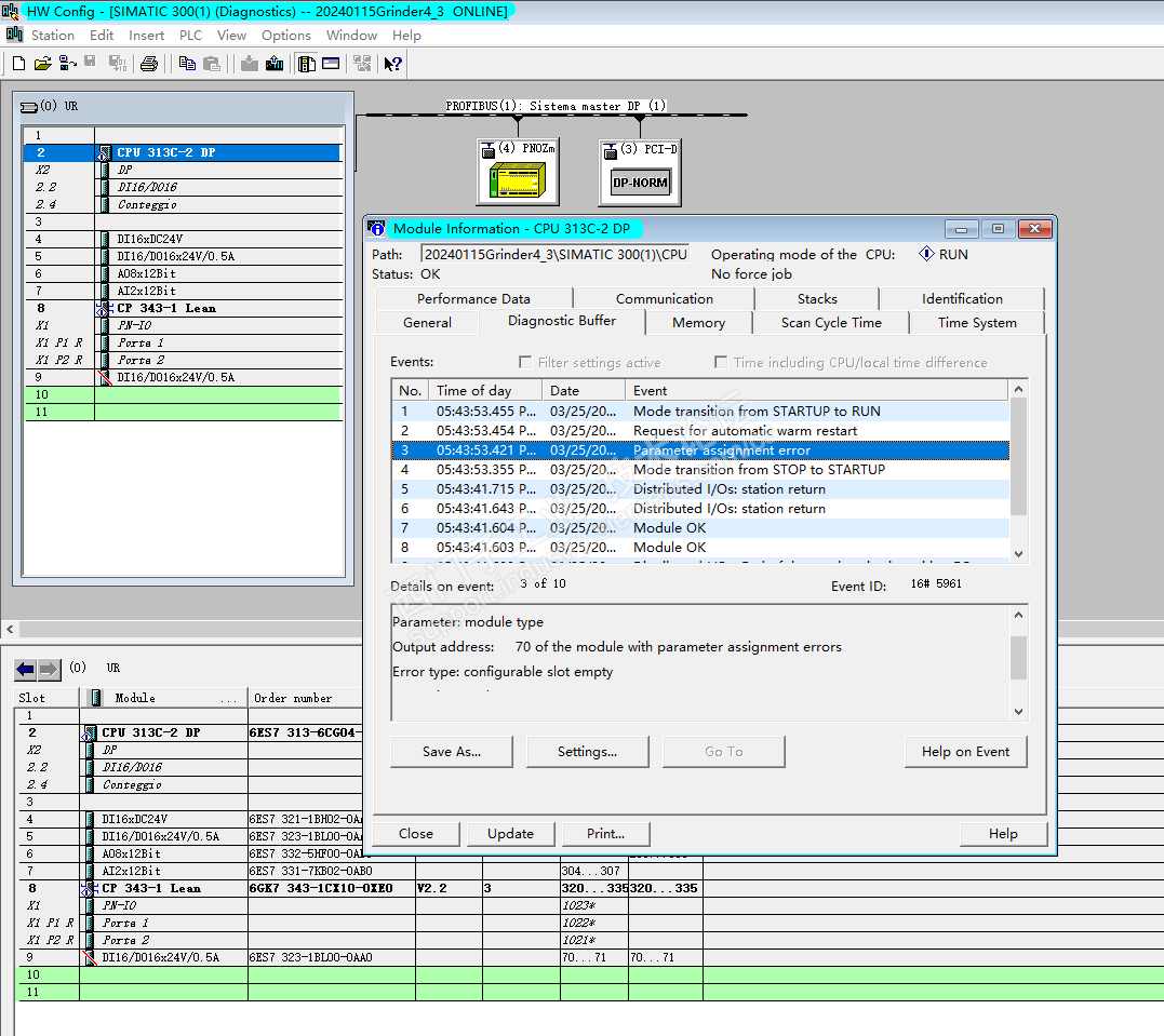

我在检查CPU无法运行的原因,有一个错误;
Parameter assignment error in parameters for central S7 modules
subrack 0
Slot    6
Error type: Slot configured for CPU is not occupied or is occupied by a place holder, or a station has failed or the switched I/O system has lost its redundancy.
Data record number: 255
Operating mode: STOP (internal)
External error, Incoming event
换了第6个插槽的全新的AO模块还是不好,然后我就往前把第5个模块的DIO和第9个模块的DIO互换,当不插上第9个模块的时候可以运行,CPU也不亮红灯,比较好奇为什么不报错呢?另外就是报错的提示和实际不一致怎么去查。
