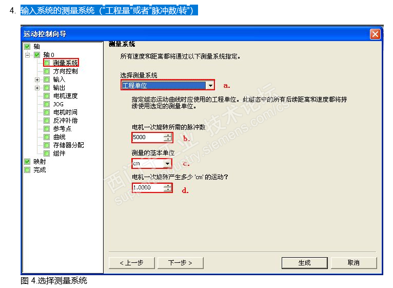

https://www.ad.siemens.com.cn/productportal/prods/s7-200-smart-portal/200smarttop/function/motion_control/motion_wizard.html
